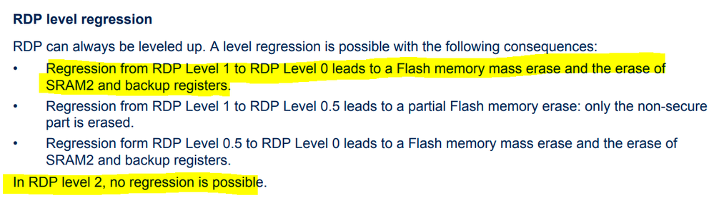

RDP2 is irreversible.
RDP1 to RDP0 is possible, but causes your chip to be erased which makes it difficult/impossible to do within your firmware while still retaining control.

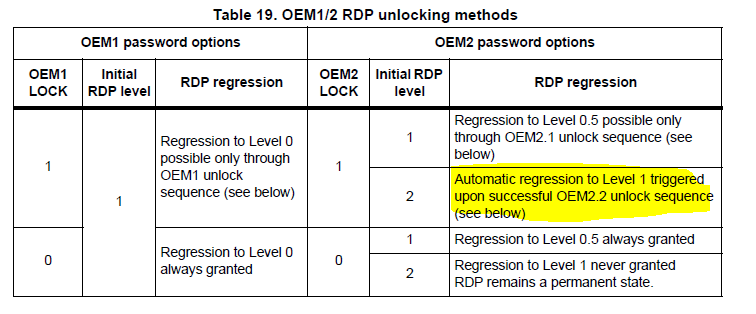

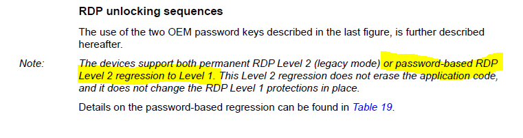

@TDK This snip is from rm0456 application note for STM32U5x5
They have supported a regression from RDP2 to RDP 1 using passwords
