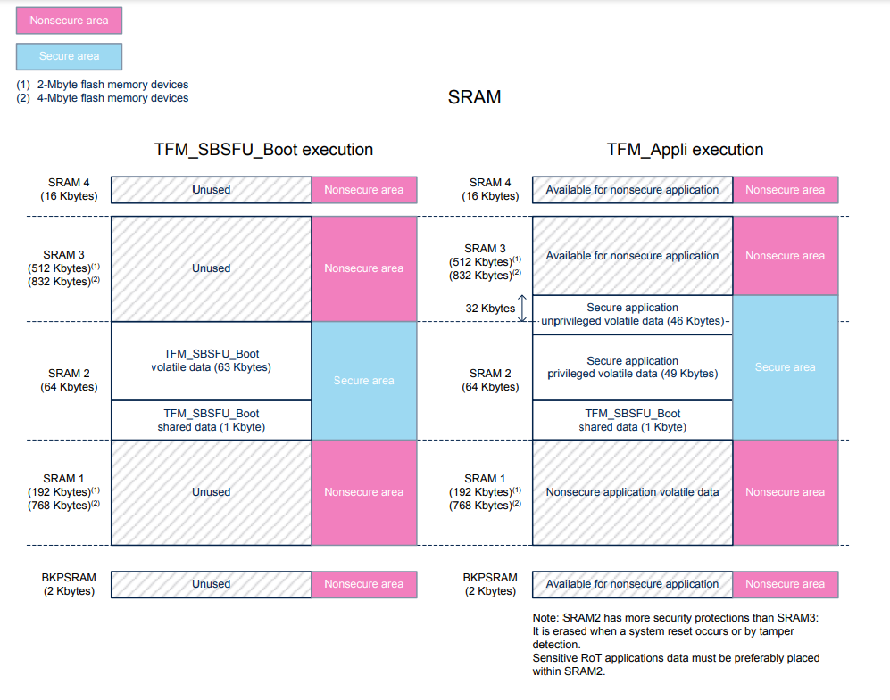

And the layout is like this according to the UM:
So, I am afraid that anyway your application cannot work properly as the SRAM2 is erased and locked.
