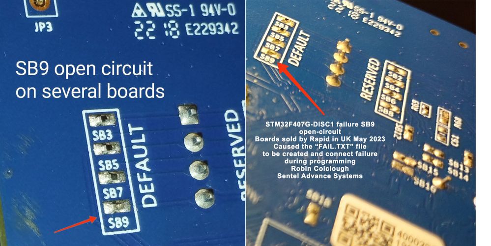

2023-07-26 12:50 PM
Manufacturing fault found on a batch of STM32F407G-DISC1 boards, after debugging the hardware SB9, a debug mode link, is open circuit on all the boards suffering from the link failure ("FAIL.TXT").
I attach a photo. Repairing link SB9 fixed the link-fail condition on all the faulty boards.

2023-07-26 12:50 PM
