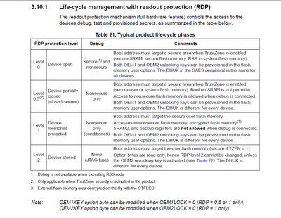

If you have activated RDP level 2 without defining the OEM2key, you have blocked your part and will no longer be able to regress, therefore erasing or reprogramming it.
You can refer to table 21 in reference Manual (RM0456)
