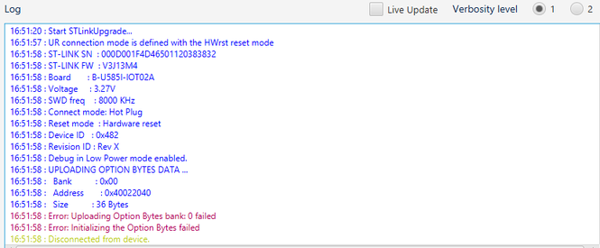

I've added the OEM2KEY AND OEM1KEY to the RDP Level 2 protection in order to perform the same steps as in the 'Getting started with STM32CubeU5 TFM application' for enabling Production Mode.
Following the steps and executing the HARDENING.SH file, I'm no longer able to modify the board or revert to RDP level 0. It's showing me the following error: Error: ST-LINK error (DEV_TARGET_NOT_HALTED)
If I enter Hotplug mode, it shows me the following: Error: Uploading Option Bytes bank: 0 failed Error: Initializing the Option Bytes failed.

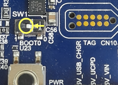

- STEP1: Ensure the switch SW1 (BOOT0 pin) on B-U585I-IOT02A board is on position 1 to boot from RSS (see below the yellow arrow).

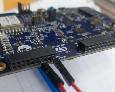

- STEP2: Connect TAMP_IN8 (PE4 on CN3 pin 11) and TAMP_OUT8 (PE5 on CN3 pin 14) on the B-U585I-IOT02A board (as follow)

It is needed to connect TAMP_IN8 (PE4 on CN3 pin 11) and TAMP_OUT8 (PE5 on CN3 pin 14) on the B-U585I-IOT02A board, to allow the application to run.

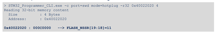

- OEM2LOCK and OEM1LOCK bits in the FLASH_NSSR register are set to be sure that OEM1KEY/OEM2KEY are already provisioned
> STM32_Programmer_CLI.exe -c port=swd mode=hotplug -r32 0x40022020 4
the result should be as follows:

I have executed the command and I obtained the following result:

Reading 32-bit memory content
Address: : 0x40022020
Error: failed to read the requested memory content

Default password in regression.sh is 0xFACEB00C 0xDEADBABE, switch SW1 (BOOT0 pin) is on position 1, and I connected TAMP_IN8 (PE4 on CN3 pin 11) and TAMP_OUT8 (PE5 on CN3 pin 14).
