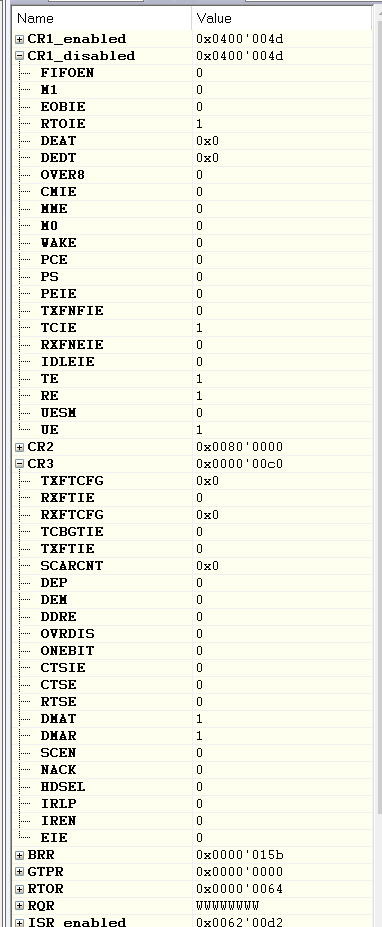

When the issue occurs, I found that the TC (Transmission Complete) flag is not being cleared:
and HAL_UART_IRQHandler return at /* End if some error occurs */

TC and TCIE are both set, and HAL_UART_IRQHandler returned before:
/* UART in mode Transmitter (transmission end) -----------------------------*/
UART_EndTransmit_IT
After problem occurs, any suspension will stop at HAL_UART_IRQHandler, I set a breakpoint in uart_tx_complete_cb, and never go in it
