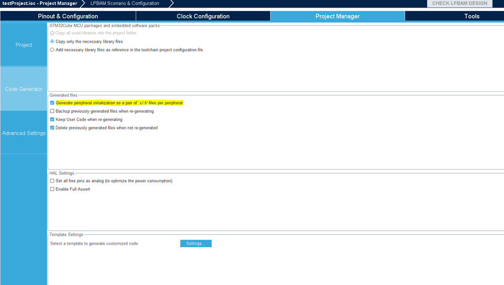

I'm using STM32CubeIDE 1.12.0 with a TrustZone enabled project and observed incorrect initialization of GTZC when the option "Generate peripheral initialization as a pair of '.c/.h' files per peripheral" is active:
If this option is not active the function HAL_MspInit() in stm32XXXX_hal_msp.c contains some code to enable the clock of GTZC1 and/or GTZC2, depending on the further configuration e.g.:

}If this option is active the GTZC clocks are not enabled in stm32XXXX_hal_msp.c any more. This is as expected. But the generated gtzc_s.c, which then contains the whole initialization of the GTZC, misses the code to enable the clock of GTZC1 and/or GTZC2.
Of course GTZC peripheral must be enabled (I enabled GTZC_S) in the Pinout&Configuration tab in order to trigger generation of GTZC initialization code at all.
