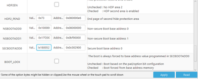

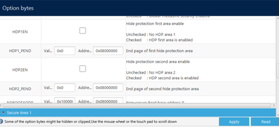

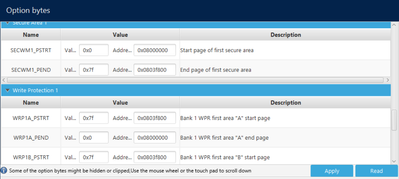

These are my Option Bytes:
Could it be something related with entering the secure side?

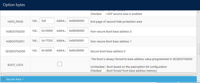

Hello @Claudia ,
The SECBOOTADD0 is set to 0x00C00000 which is wrong. It should be 0x0C000000.
So when you launch the debugger, debugger forces the boot address to match the one from the elf file. But as soon as a reset is triggered the MCU jumps in wrong address.
Setting the right boot address should solve your debugging issue
Best regards

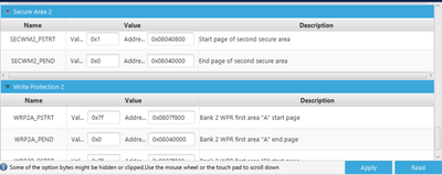

Yes, you are right, I had a wrong SECBOOTADD0. Several weeks ago I tried with the following configuration and had the same problem:
However, I have a bigger problem than before. I tried disabling TrustZone and got the same as in this post:
After trying to Disable Trustzone, no longer able ... - STMicroelectronics Community
Is there any way to solve this?
Thank you in advance,

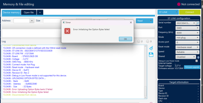

Thanks for your reply,
I tried booting from RSS by connecting BOOT0 pin to VDD as suggested in um2617 (Chapter 6.4.2). However, I got the following message "Initializing Option Bytes failed":
It seems that booting from RSS does not change things in my board.
Do you have any more suggestions? Thank you very much for your interest.
Claudia

2024-02-02 3:59 AM
I was able to connect to the board following your instructions and I was also able to debug everything perfectly. The only thing I had to do was to change the option byte SECBOOTADD0 as you advised.
Thank you very much for your help and patience.
