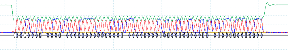

CRC32 with polynomial = 0x1EDC6F41, init value = 0x55555555. (no input/output reverse)
I send 4 bytes (0x12, 0x34,0x56,0x78) through SPI communication and on scope I measure what is phisically sent:
Frame: 0001001000110100011110000101011000000101001001001010101101110011
datas = 0x12347856 (00010010001101000111100001010110) --> the second half-word= 0x7856 is sent through little endian convention
CRC32 = 0x0524AB73 (00000101001001001010101101110011)
I can't get the same value (CRC32 = 0x0524AB73) with the algorithm
I use the same algorithm as you: CRCToCheck = Crc32(0x55555555, 0x12347856)
CRCToCheck = 0x27F11ABF ( != 0x0524AB73)
I also tried to fill with empty value 0x00000000 after these 4 Bytes, after 31999 iteration I stop it. CRC is still not equal.
Could you help me to know why the CRC is not good equal to hardware CRC?
