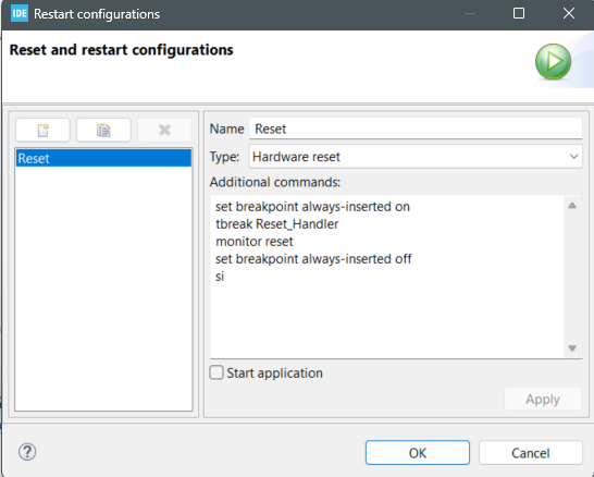

In order to use reset from STM32CubeIDE you also need to setup the reset behaviour like this
If it is hardware reset or system reset then the Secure Manager will be relaunched, the application started, then stopped and PC and registers reset to either the reset handler or run to main if you tick the Start application.
If you select software reset or none, then no reset of secure manager is done, only reset of non secure part.
Best regards
