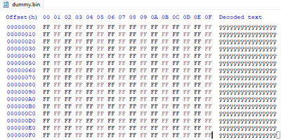

Create dummy.bin that is filled with 256 bytes of FF's. For example with HxD tool.

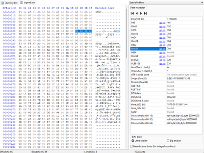

View the signed.bin with hex viewer (e.g. HxD) at offset 0x6C which is Image length by UM3234 rev 2:
It is 0x2C0 = 704. This is 448 bytes more than original 256 bytes.
