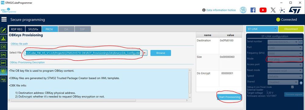

2024-11-05 1:17 AM
Hello @CRE
As you are in provisioning state, you can still doing the provisioning manually.
Launch cube programmer GUI, connect in hotplug mode.
Then click on the shield, select the DA_config.obk ( from the Cube) and start provisioning.
Then you should have a pop-up that the povsioning was success full.
Once this done the regression script could be launch.
Or you can do the regression thank cube programmer GUI.
Br,
Frantz
2024-11-05 2:58 AM
Hi Frantz,
Thank you a lot for the quick and detailed answer.
I put your suggestion to trial:
- manual provisioning : appeared to be successful. Yet, the device was still in PROVISIONING state after that.
- regression : with the script or from STM32Programmer, both failed. The process went a bit further than before (signing token):

2024-11-05 5:03 AM
Hi Frantz,
You fixed it ! My board is back to OPEN, and I will be able to resume my training.
And I will carefully follow every step of the wikis, and avoid messing around.
Thank you a lot.
