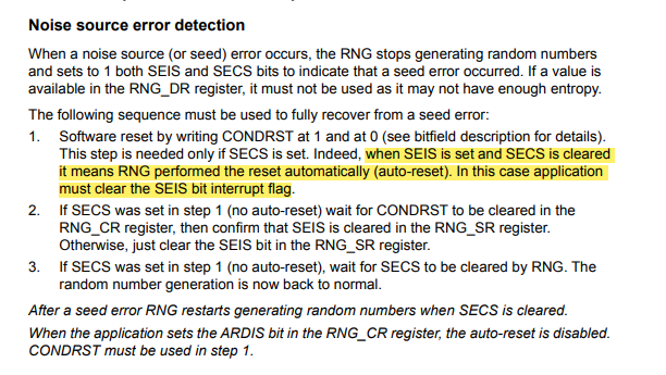

2025-01-14 6:29 AM
Hello @hicham75 ,
Thank you for sharing this.
You will need to clear this flag as you don't have SECS and only SEIS is set indicating that the RNG has automatically recovered for the error and you application must clear this flag in order to make PKA init working properly
it is worth noting that this will not impact the security entropy or performance of your application since you are using the recommended configurations in AN4230.

2025-01-14 6:32 AM
Hi @STea ,
Thank you for your reply.
Unfortunately, I've already read that in another post. I tried to clear it but it will be set few instructions later.
Even, If I ignore it and proceed, PKA_SR_INITOK will not be set and PKA init will timeout.
I think it's related.

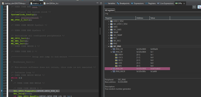

2025-01-20 3:11 AM
Hello @hicham75 ,
can you mention the steps you are following to execute this Firmware, as when I tried to debug it there is no problem in the RNG and PKA init functions:
Regards

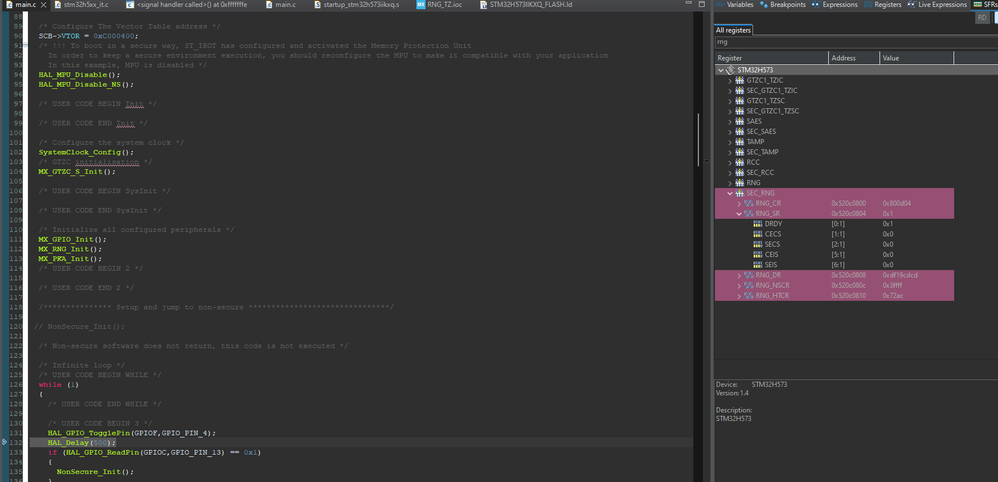

2025-01-20 5:08 AM - edited 2025-01-20 5:09 AM
Hi @STea
I use gdb for debug. I run the program with a breakpoint on MX_RNG_Init() and dispalys RNG structure:
after step over MX_RNG_Init() is executed, I step into MX_PKA_Init(), then after one or two instrctions, RNG->SR = 0x41.
I see unexpected values regarding RNG NSCR and HTCR registers in your screenshot.
Yours, do not contain NIST values but seems to contain default ones.
using NIST value(for configuration A), those registers should contain : 0x3aff66 and 0x6a91 respectively.

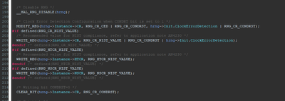

In zip file I handed to you, I was using HAL v1.3.0 which contains an bug for HAL_RNG_Init. I patched that issue ( STM also fixed it, as I see, in v1.4.0).
the wrong line is at file stm32h5xx_hal_rng.c:204
The fixed one is :
as per RM0481, when ever you need to update configuration, you have to set CONDRST bit at same transaction.
it seems for some reasons, you are not using HAL provided in ZIP archive.
