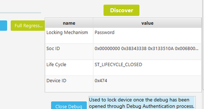

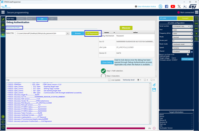

I am using the CubeProgrammer v2.20 for an STM32H503 now and the regression is NOT working for me.
I use this password file with a 16byte test password:
The CubeProgrammer signals that the "Debug opened successfully", but the target is still in CLOSED state.

No really I think im doing it right. Im in the password Debug-Authentication dialog and i am pointing to my password file, as stated in the dialog hint. My controller is in CLOSED state and the regression will not work.

With this, I could successfully perform a regression with the GUI STM32CubeProgrammer.
But man I am a bit angry that there is no documentation about the structure of this password.bin file that you have to use to perform the regression. What does this bit in the header do?
Anyway, the original problem is solved, and thanks for the support.

Now I'm having similar issue. I followed the guide https://wiki.st.com/stm32mcu/wiki/Security:How_to_start_with_DA_access_on_STM32H503 guiding me to "Make a first trial setting the product in PROVISIONED state: "
And now it seems I cannot get out of Provisional state. I tried regression.bat and CubeProgrammer GUI pointing at my da_password.bin, but every time I try to connect I get the error
SDMAuthenticate : 1382 : client : Error parsing password file ()
The first 4 bytes in the file are 0x00, 0x00, 0x00, 0x80 as MarcelP shows it should be?
Any other things I should try out before dumping my Nucleo board in the trash?
