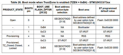

The following table from RM0481 does not help here:
And additionally, it is even confusing because (as you said) with Secure Manager we have BOOT_UBE set to 0xB4 which would not boot through STiRoT/SMiRoT according to this table.

You are right, I couldn't find an explicit statement in the Secure Manager associated documentations: AN3254 and the wiki
Now, in this state you are able to download the non secure binary and test it without having to provide the signed image. So, you can imagine there is a bypass at this stage.
Now you can still download a signed image and you will be able to get image status. This allows validating your update mechanism.
Regarding the boot details, Secure Manager boots on SMiROT and not on STiROT. This is explained in AN3254 Rev8 chapter 1.3.1
Best regards
