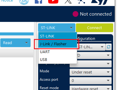

But STM32CubeProgrammer supports also J-LINK:
Did you try the same steps with this config?

Hello @gatadivijay ,

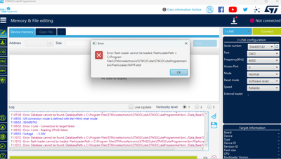

2024-10-28 8:11 AM
When I try this I got below issue. How can I resolve this.
