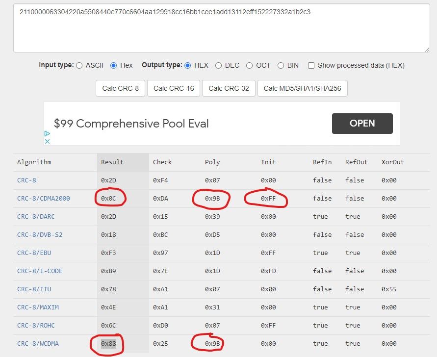

However, when the same group of the data is tested with other CRC calculator for Poly 0x9B, eg. https://crccalc.com/, the result is 0x88 instead of 0xA6.

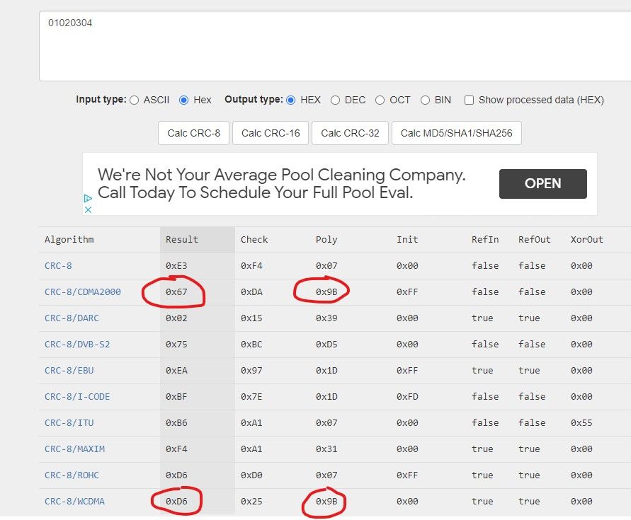

Then I tried another example (different data set 0x1, 0x2, 0x3, 0x4) with HAL, the result doesn't match either.

2020-09-07 3:59 PM
Post input, polynomial, initial value, expected output, real output.
2020-09-07 4:11 PM
Also keep in mind the polynomial is just one part of the CRC. The Initial value, RefIn, RefOut and XorOut will also affect the result.

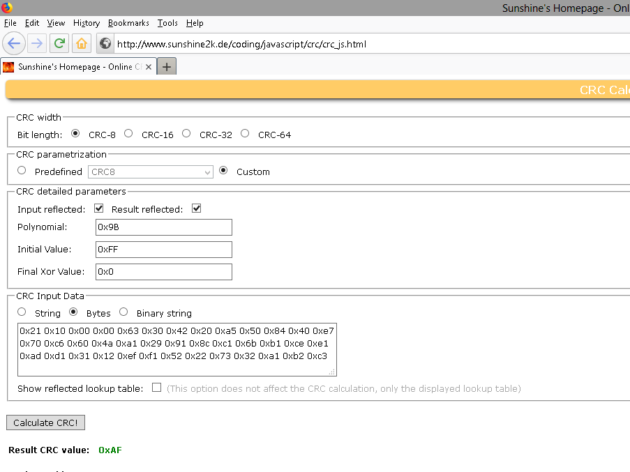

2020-09-07 10:38 PM
I tried both http://www.sunshine2k.de/coding/javascript/crc/crc_js.html and https://crccalc.com/. These two match well.
Then I tried various Input/Output Reflect (Reverse or Non-reverse), Initial value(0x0 or 0xFF). So far, none match the result from above sites.
Maybe only ST guys with internal info can solve the puzzle. It's from their example, wonder how they verified the result.
2020-09-07 11:27 PM
The screenshot I gave above matches the value you said in initial post comes from STM32.
Did you observe the CRC registers during calculation? Show us, what you've seen, for a simple example.
