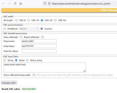

The CRC unit in 'F1 calculates CRC only from 32-bit words, so for example for your 0x01 input it uses 0x00000001 (big endian, so 0x00 0x00 0x00 0x01):

2024-10-04 12:26 AM
