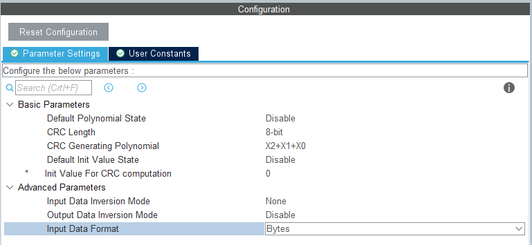

I am working on SMBus communication and i want to calculate PEC (packet error code) value. PEC value is using CRC-8 checksum with 0x07 polynomial. I want to use CRC peripheral in STM32G031F6 for PEC calculate. Cubemx settings are below.

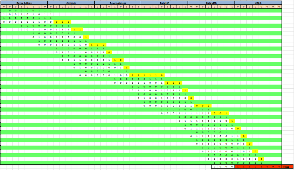

SMBus_PEC = HAL_CRC_Calculate (&hcrc, CRC_Data, 5);SMBus_PEC value is 0x54 but this is wrong. It must be 0xE8. I am calculating with online CRC calculation from this site ==> https://www.lddgo.net/en/encrypt/crc
I read from the SMBus PEC value is also 0xE8. Also, when I calculate it manually, i get same value.

Hi Waclawek.jan.
CRC_Data is not byte. It is uint32_t. I changed to unsigned char. But HAL_CRC_Calculate function gave an error because data array is uint32_t defined. I changed the program as follows;
SMBus_PEC = HAL_CRC_Calculate (&hcrc, (uint32_t*)&CRC_Data, 5);Before making this change, when I changed the variables in the CRC_Data array, the PEC value did not change. But now it is changing and working. :grinning_face_with_sweat:
Thanks for your help, mate. :thumbs_up:

2022-04-05 3:47 AM
Hi Chloe.
CRC calculate function using "uint32_t" for data buffer.
HAL_CRC_Calculate(CRC_HandleTypeDef *hcrc, uint32_t pBuffer[], uint32_t BufferLength)I defined data buffer as uint32_t. I explained in detail above. This is exactly the problem.
Thanks for your support. :thumbs_up:
