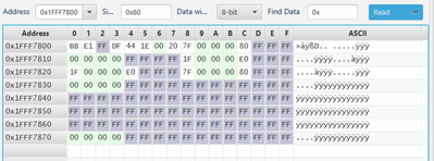

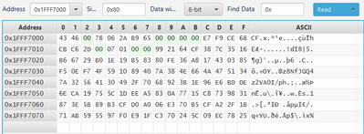

You can see from my last screenshot that you can indeed read OTP while RDP is set to level 1.

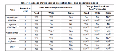

It turns out the OTP is expected to have read access under RDP level 1.
I think that's very undesirable and hope ST will change this in the future since OTP is the perfect place to store things like encryption keys, serial numbers, etc.
The table below is from RM0454 Rev 2:
2024-05-25 2:47 AM - edited 2024-05-25 2:50 AM
Thanks for coming back with the solution. Please click on "Accept as solution" in that post so that the thread is marked as solved.
I wonder what caused the problematic nBOOT_SEL option bit. It can't be wear, as the inverted value is always matching the "straight" one, even after the surprising change during powerdown.
I have doubts about the OTP lock and start a separate thread to ask ST for comment, as it is a separate problem from this (btw. have a look at the table you've posted, in the newest revision of RM0454 - it differs exactly in this detail).

Hello @DAlbe.3 ,
I confirm OTP value can be read in RDP1 on STM32G0. I checked on few different G0 part numbers.
I will raise the point internally to get the RM fixed.
