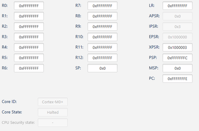

2024-05-24 8:18 AM - edited 2024-05-24 8:29 AM
Interestingly, I was able to connect using an STLinkV2 under SoftwareReset.
From the STM32CubeProgrammer, I can perform a core or hardware or software reset, but it always lands back in the above configuration. I can access the registers, and read OTP (flash is protected with level 1) so if there's something worth looking at, suggestions are welcome!

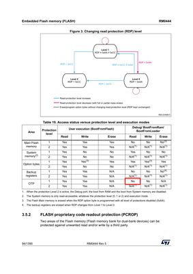

2024-05-24 8:23 AM
Ugh, I also just found that RDP level 1 does not protect the OTP from read access (at least not when using the STLink).

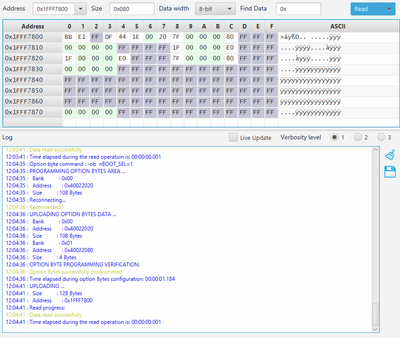

2024-05-24 8:43 AM - edited 2024-05-24 9:05 AM
Some progress!
It seems that STM32CubeProgrammer is not successfully setting the nBOOT_SEL bit.
It claims it does:
11:30:31 : Option byte command : -ob nBOOT_SEL=1
11:30:31 : PROGRAMMING OPTION BYTES AREA ...
11:30:31 : Bank : 0x00
11:30:31 : Address : 0x40022020
11:30:31 : Size : 108 Bytes
11:30:31 : Reconnecting...
11:30:32 : Reconnected !
11:30:32 : UPLOADING OPTION BYTES DATA ...
11:30:32 : Bank : 0x00
11:30:32 : Address : 0x40022020
11:30:32 : Size : 108 Bytes
11:30:32 : Bank : 0x01
11:30:32 : Address : 0x40022080
11:30:32 : Size : 4 Bytes
11:30:32 : OPTION BYTE PROGRAMMING VERIFICATION:
11:30:32 : Option Bytes successfully programmed
11:30:32 : Time elapsed during option Bytes configuration: 00:00:01.215

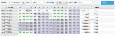

And reading back the option bytes region shows the bit set,
but after power cycle and re-reading the option bytes, you can see that nBOOT_SEL (bit 24) is not set!

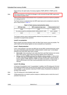

That's also humm and interesting, but I'm not sure how does that explain your findings.
So, how is your PA14/BOOT connected?
Also, note that the erratum you've quoted (2.2.3, Under Level 1 read protection, booting from main flash memory selected through PA14‑ ‑BOOT0 pin is not functional) pertains only to Rev.Z of the chip. So, what revision do you have? The CubeProgrammer screenshot, characteristically unhelpfully, says, Rev 1.1...
