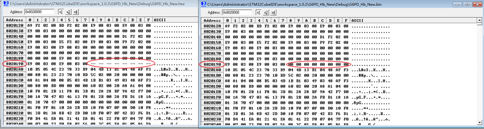

Today when I generated CRC from output binary file I found it did not equal the data in the board. Then I check the data in board , I found the data which loaded by stm32CudeIDE was padding with 0xFF, but the stm32CudbeIDE generate the binary file with padding 0.

You might want to set all alignemts to 16, see https://community.st.com/s/question/0D50X0000BcRdMKSQ0/flashing-stm32f0-fails-in-cubeide-when-the-firmware-has-a-certain-length-0x1c04-or-0x1c08-bytes
