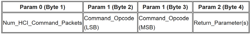

An HCI command complete packet should have the following format:

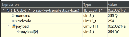

But the command opcode fields do not reflect the opcode of SHCI_OPCODE_C2_REINIT (0xFC6F), but are instead set to the returned error code (254 / 0xFE, coincidence?):
(this is taken on the return line of SHCI_C2_Reinit in shci.c)
For other commands (checked SHCI_C2_FUS_LockUsrKey and SHCI_C2_FUS_GetState) the cmdcode field is set correctly.
Is there a problem with the SHIC_C2_Reinit command? Is it somehow an expected behaviour (but why then is __SEV() during application/loader C2 init not working?)
