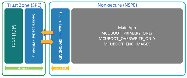

2024-03-23 4:05 PM - edited 2024-03-24 2:40 PM
Hi @Jocelyn RICARD,
Back to my original question and solution I need to implement - see the revised/simplified version below.
The main difference of the solution I need compared to SBSFU is that my Secure Loader must be self-updatable, hence it needs to use two slots since any update failure will brick the device. It must also be able to update the Main App using in-place decryption, which I think can be accomplished with MCUboot using MCUBOOT_PRIMARY_ONLY/MCUBOOT_OVERWRITE_ONLY/MCUBOOT_ENC_IMAGES config.
Of course, MCUboot does not support mixed update strategies so my Secure Loader will only use MCUboot pieces to decrypt Main App image in-place.
Do you think this approach is feasible?
2024-03-27 11:54 AM
Hello @TDJ,
Your loader will be able to download your application but it does not have access to the key to decrypt it.
So, decryption in place of the application will be done by the mcuboot after loader has reset the target.
You need to implement specific mechanism to manage your loader update from mcuboot.
I'm not sure how it can be done the way you show it using mcuboot itself as it will be setup in primary only.
I don't have simple solution in mind for that. You would need a dual slot setting for the loader and single slot setting for the application which I don't think is possible in current mcuboot implementation but I don't know all the details ...
Best regards
Jocelyn

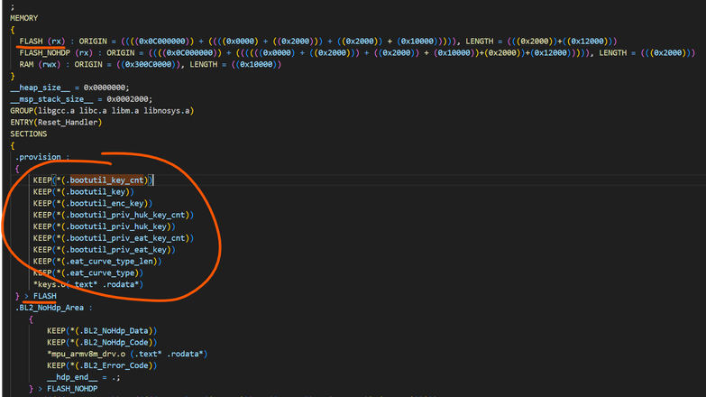

2024-03-29 1:50 AM - edited 2024-03-29 5:51 AM
Hi @Jocelyn RICARD,
I think my "secure loader" app should be able to access MCUBoot keys since they are placed at well know location - see the output linker script image below. Am I missing something? If I do, then another set of keys/secrets have to be embedded with my "secure loader". It would not be a perfect solution, but it would be acceptable.
When it comes to "secure loader" app, I am on my own and I need to put it together from scratch however borrowing large parts of MCUboot, using ThreadX/UsbX/FileX and all the HW acceleration/security config from SBSFU, but probably it is a manageable task.
Kind regards,
Tomasz
2024-03-29 7:17 AM
Hi @TDJ ,
Your loader can have access to the keys in mcuboot if you don't enable the temporal isolation.
You will need to disable TFM_HDP_PROTECT_ENABLE flag to avoid the activation for this protection.
This means your loader and application will have access to the keys. For firmware authentication public key this is not a problem as long as it cannot be changed. But for firmware encryption private key, this is less secure.
One improvement could be to set the HDP limit to your loader. This way all mcuboot + loader are protected when application runs.
Best regards
Jocelyn
