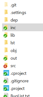

This is our project directory structure.
I am unsure of the best way to alter / setup the project to work with SBSFU.
