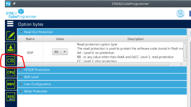

So default value of RDP = 0xAA which is RDP level 0.
You can modify the option byte could be change thanks programming tools like STM32CubeProgrammer.
You can modify it in command line :
cd "\Program Files\STMicroelectronics\STM32Cube\STM32CubeProgrammer\bin"
STM32_Programmer_CLI.exe -c port=SWD mode=UR -ob RDP=0xBB
If you are using an other programming tools, you probably have interface to change option byte.
