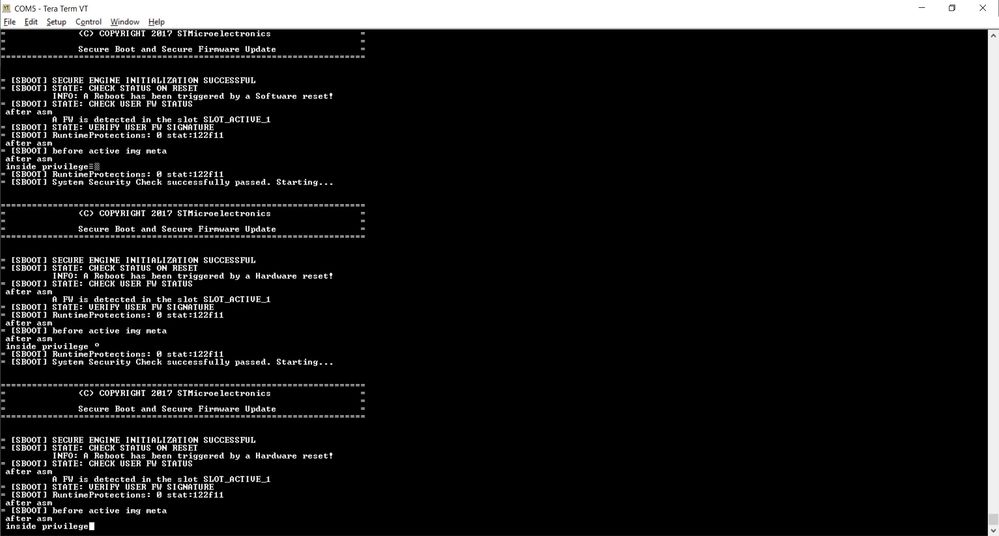

I am using the SBSFU STM32CubeExpansion_SBSFU_V2.6.2 version for my custom board STM32H743VI controller. I have ported the STM32H7B3I-DK project for H743 controller for COM port and changed the crypto scheme to SECBOOT_ECCDSA_WITHOUT_ENCRYPT_SHA256.
I am getting below logs and hangs. It hangs in the below code,

After SE_SysCall() call, there is no message. Please suggest the next steps to debug it.

Hello Rakkumuthu,
The SBSFU package provides an example for STM32H753 which is the crypto version of STM32H743.
With this example you should have a setup directly working.
If you still want to use the STM32H7B3 example, you will need to adapt the flash driver because it is different (8KB sectors instead of 128KB).
You can get flash driver from STM32H753 example though.
In any case, you should be able to use debugger to understand what happens precisely.
You would only need to add secure engine symbols in addition to the SBSFU symbols to be able to continue debugging inside secure engine.

Used STM32H753 example to solve it.
