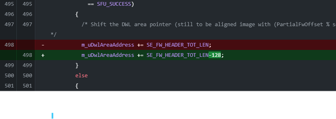

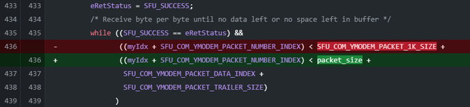

2025-05-29 3:14 AM - edited 2025-05-29 8:45 AM
Alright after two full days of untangling spaggeti.
The magic changes that make the SBSFU 2.7.0 , u FW update work with minicom are: (only 128 bytes packet size)
To fix YMODEM transmission:
To fix the padding bytes mess from the FW update (128==SFU_COM_YMODEM_PACKET_SIZE)
If ST had this code in a public git repo i would create a bugfix report, but they dont .... :D , and they labeled the code as legacy and not supported.... release it to the community, come oon!

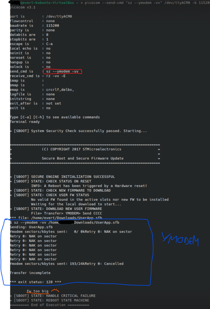

2025-05-22 6:17 AM - edited 2025-05-22 9:30 AM
im more concern about what i am doing wrong because ST says the code supports miniCom.
ill try putty aswell thanks @AScha.3
Edit, putty (plink) doesnt support YMODEM
2025-05-22 9:28 AM - edited 2025-05-22 9:31 AM
im trying again with my raspi forcing YMODE to use 1k block size
console1 opens the serial port:
minicom -b 115200 -D /dev/ttyACM0
console2 uses the opened serial port:
sz -k --ymodem /media/greenUSB/UserApp.sfb > /dev/ttyACM0 < /dev/ttyACM0
result: are those garbage ACK errors?
Sending: UserApp.sfb
Ymodem sectors/kbytes sent: 1/ 0kRetry 0: NAK on sector
Retry 0: Got 49 for sector ACK
Retry 0: Got 41 for sector ACK
Retry 0: Got 4e for sector ACK
Retry 0: Got 68 for sector ACK
Retry 0: Got 4f for sector ACK
Retry 0: Got 55 for sector ACK
Retry 0: Got 53 for sector ACK
Retry 0: Got 48 for sector ACK
Retry 0: Retry Count Exceeded
Transfer incomplete

Im cornering the "FW too big" problem to this line inside SFU_COM_YMODEM_DataPktRxCpltCallback()
/* Check size to avoid writing beyond DWL image size */
if ((m_uDwlAreaAddress + rx_size) > (m_uDwlAreaStart + m_uDwlImgSize))
m_LoaderStatus = SFU_LOADER_ERR_FW_LENGTH;
e_ret_status = SFU_ERROR;
m_uDwlAreaAddress = always 0x8048000
m_uDwlAreaStart = changes ?
rx_size is always 128
m_uDwlImgSize = received image size by YMODE block 0 info, (in my case 24704)
i believe the last packet being received is not expected?
Kudos a @Pavel A. for the support
