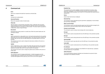

According to Figure 12 "Wrap/Unwrap Local Envelop command flow" on page 21 of the datasheet, it seems that the encryption and decryption of plaintext are processed on the local host(here, NUCLEO-L476RG) side.
On the other hand, the command set list on page 23 includes Encrypt and Decrypt, indicating that STSAFE-A110 seems to provide encryption and decryption functions. Are there commands not implemented in the software of X-CUBE-SAFEA1?

According to the datasheet, page 22, STSAFE-A110 provides us Encrypt and Decrypt commands.

Hi @YUTA1 ,
on STSAFE-A110, the encrypt/decrypt API are not accessible as you can't store the key you need in the symmetric key table.
For this feature, you have to use STSAFE-A120 which has different way of loading a symmetric key and supports more AES variant.
