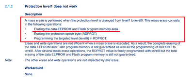

Seems that when I update the version of customer firmware, the EEPROM data is erased. Seems that jumping from Level1 to Level0 produce a mass erase, and in consequence, the EEPROM is erased as well.
I would like to know if I'm right.
Jumping from Level1 to Level0 produce a mass erase, that produce erase the internal EEPROM as well?

Hello @albertLDS and welcome to the ST community,
@albertLDS wrote:
Hi there,
According to the errata sheet page 5:
Hope that answers your question.
