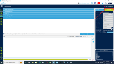

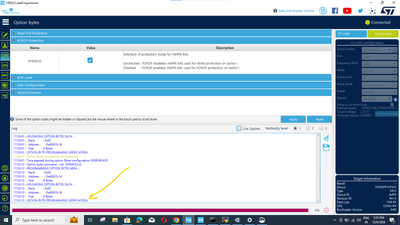

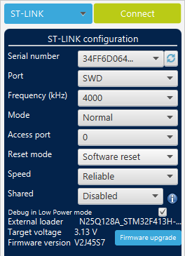

Enable and Disable the SPRMOD check box
ENABLE the SPRMOD:
Step1: Connect the MCU via JTAG/SWD

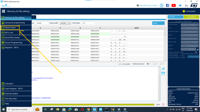

Step 2: Open the STM32CubeProgrammer or Download the STM32CubeProgram- Link: https://www.st.com/en/development-tools/stm32cubeprog.html
Step 3: Open STM32CubeProgrammer and press the Connect button.
Step 4: Go to Option bytes

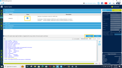

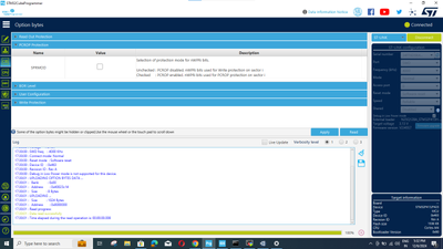

Step 5: Check the SPRMOD
Step 6: Successfully Enable the flash protection

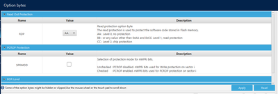

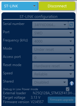

Disable the SPRMOD:

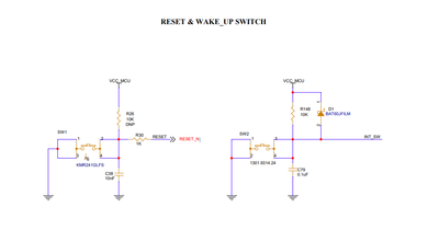

Step 1: MCU has RESET switch (SW 1). Press the Switch (Hardware Reset Switch)
Step 2: Disconnect the ST_Link

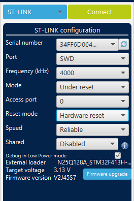

Step 3: Change the Mode to Under reset and Change the Reset mode to Hardware reset.
Step 4: After Connect the MCU via ST_Link

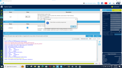

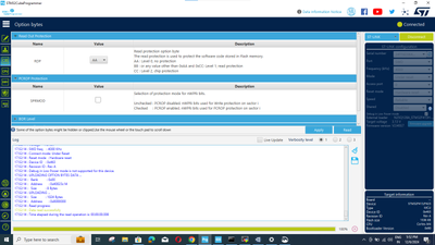

Step 5: Change the RDP from AA to BB
Step 6: Click Apply
Step 6: Change RDP to AA and Uncheck the SPRMOD
Step 7: Click Apply
Step 8: Finally Disconnect and Connect the MCU for checking process.
