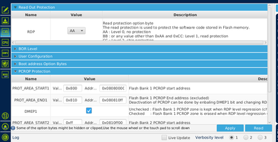

I'm experimenting PCROP activation on stm32h743 following this ST-tutorial: https://youtu.be/7Wr90XFA8_Q?si=tDpqUtMdin9Oyn-P
The activation works fine but i cannot disable PCROP using CubeProgrammer.
I did a RDP1 to RDP0 regression with DMWP1 checked but the PCROP is still active

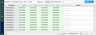

After RDP regression i can se that the unprotected flash are is erase:

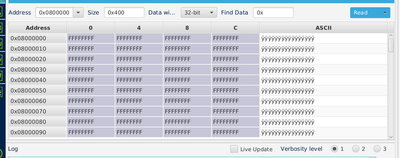

But not the protected one:

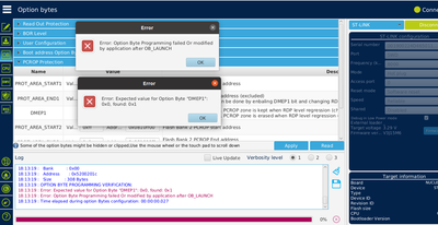

I can also not change the option bytes anymore, even RDP0 to RDP1 does not work
How can i recover from this situation ?
2024-06-06 5:28 AM - edited 2024-06-06 5:30 AM
Hi @Jocelyn RICARD ,
now PCROP is removed and the device is working fine! :)
If you encounter the same problem a "bank mass erase with automatic protection-removal" as described in the reference manual could help you:
__HAL_FLASH_CLEAR_FLAG_BANK1(FLASH_FLAG_ALL_ERRORS_BANK1);
HAL_FLASH_OB_Unlock();
SET_BIT(FLASH->PRAR_PRG1, FLASH_PRAR_DMEP);
uint32_t temp = ~((0xFFF << 0) | (0xFFF << 16));
FLASH->PRAR_PRG1 &= temp; // Clear bits 11:0 and 27:16
FLASH->PRAR_PRG1 |= (2 << 0);
FLASH->WPSN_PRG1 = 0xFF;
HAL_FLASH_Unlock();
SET_BIT(FLASH->CR1, FLASH_CR_BER);
SET_BIT(FLASH->CR1, FLASH_CR_START);
while (READ_BIT(FLASH->SR1, FLASH_SR_QW) > 0) {} // Wait for erase completion

UPLOADING OPTION BYTES DATA ...
Bank : 0x00
Address : 0x5200201c
██████████████████████████████████████████████████ 100%
OPTION BYTE PROGRAMMING VERIFICATION:
Option Bytes successfully programmed
Time elapsed during option Bytes configuration: 00:00:04.561
So, could you please try using same commands an show the traces?
Best regards
Jocelyn
2024-06-06 2:13 AM
Hello @Jocelyn RICARD ,
here is the result i got for the first command, maybe because the PCROP for this area is already active?
./STM32_Programmer_CLI -c port=SWD mode=UR -ob PROT_AREA_START1=0x800 PROT_AREA_END1=0x810 DMEP1=1
STM32CubeProgrammer v2.16.0
ST-LINK error (DEV_CONNECT_ERR)Best regards

@Jocelyn RICARD ,
I think the careful solution would be to perform a mass erase with automatic protection-removal as described in RM0433 page 168.
Currently i can flash code on the board on the non-pcrop region if i don't trigger a flash erase before flashing.
I don't want to try to enable RPD1 because if the regression doesn't work i cannot flash any code again because the flash will be locked once i connect the debugger.
