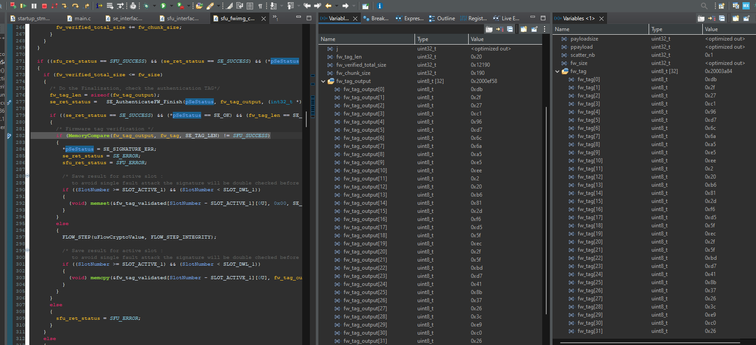

Below we see that the fw_tag_output is correct and the installed image pass the check

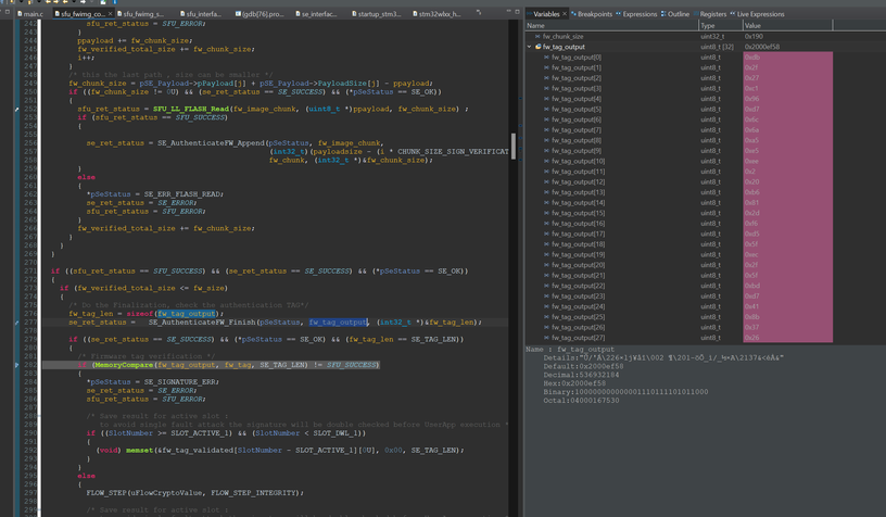

Now we see that the same application when i send the .sfb file over y-modem for update the kms returns the wrong number.
Both of the images tag are the same and in correct place. All the partitions have been checked and are the correct ones. The same application with the internal flash works ok.

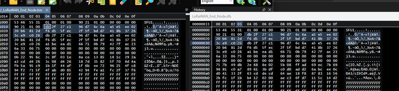

The authentication tag on both firmwares (full firmware .bin & Generated .sfb) is the same on the beginning section 0x200.
The C_DigestFinal when is called shouldn't be always check with the same tag? What i mean is that the Authentication tag key with size 32 bytes on the first section of the flash is always the same?
Below is the image from both header binary files. The tag values are the same.

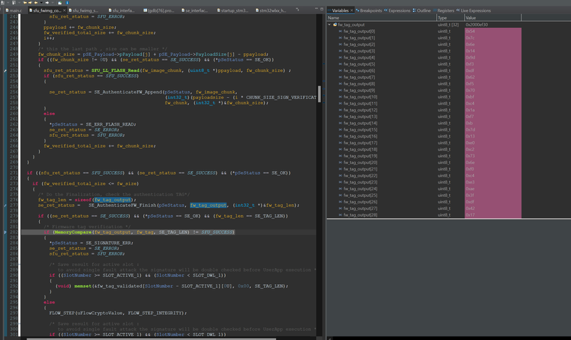

The result using the full image BFU + Firmware:

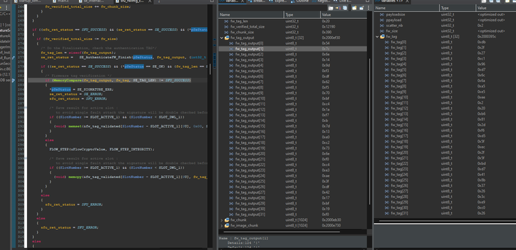

The same during update from the y-modem:
