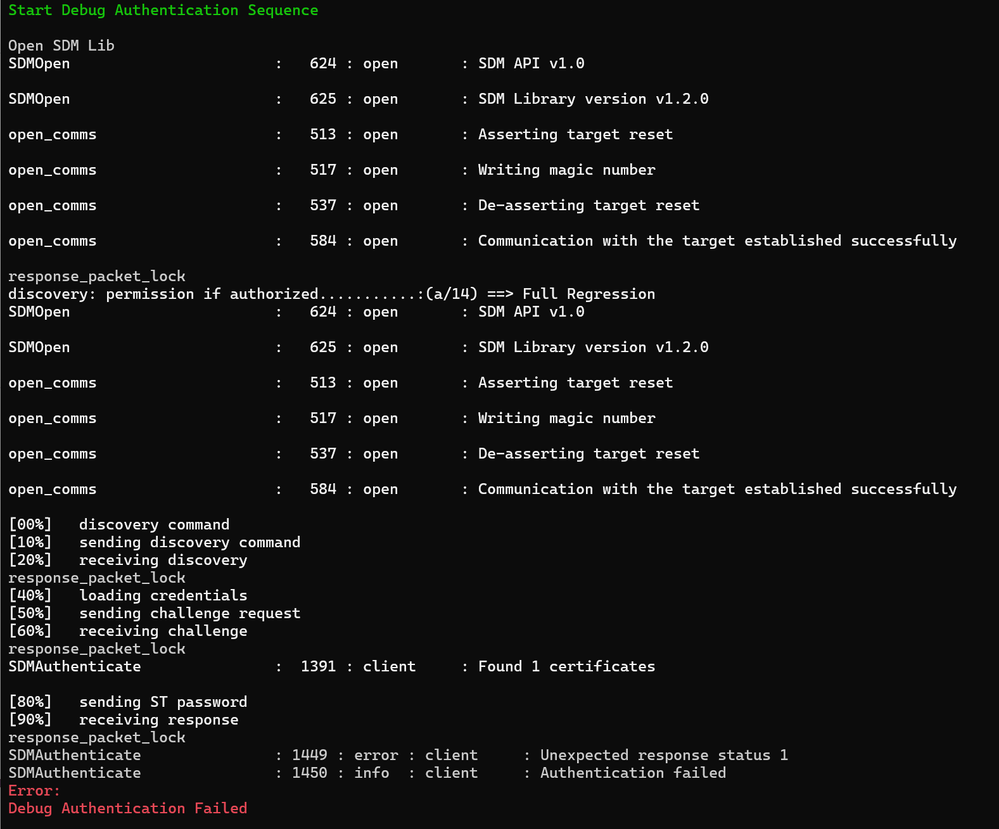

But i also tried to open a debug session. Without success. CubeProgrammer says, that I am able to make full regression only, while Cube IDE asks for certificate DA.
I know, that certificate auth method is valid with TZEN=1 only, but I tried to provision that obk with TZEN=0.
As a result, I Have this:
The default ST password from CubeProgrammer's folder is not working,
I tried to provide all-zeros and all-FF password without success.
But maybe I need to change something in the header. Or change a password length.
So, 3 questions:
1. Is this device totally bricked, or I can some-how calculate a password.bin
2. How to perform debug in closed product state on STM32H563 if TZEN=0 ?
3. How to perform debug of the the secured firmware when TZEN=1

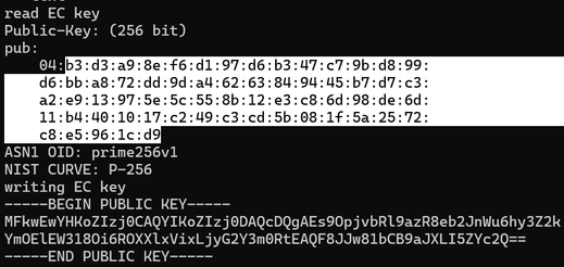

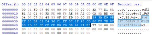

2025-09-18 6:23 AM - edited 2025-09-18 6:25 AM
Solution for the case where you provisioned ConfigWithCertificate.obk, with TZEN=0 and push ProductState to Closed :
2025-09-18 2:47 PM
Hi @Konstantin_Z ,
very smart solution !
If debug authentication firmware in STM32H5 support 32 bytes password it should work indeed
Best regards
