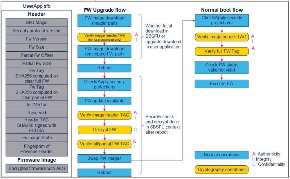

@Fred Are we replacing ACT SLOT Header with DNLD_SLOT HEADER on swapping of ACT and DNLD Slots ??
If we are swapping headers as well, we are loosing last IMAGE STATE right ??

Yes, if you update the software, then you update the header, that's true.
And it makes sense to loose the image state because it is a new software you need to validate again.

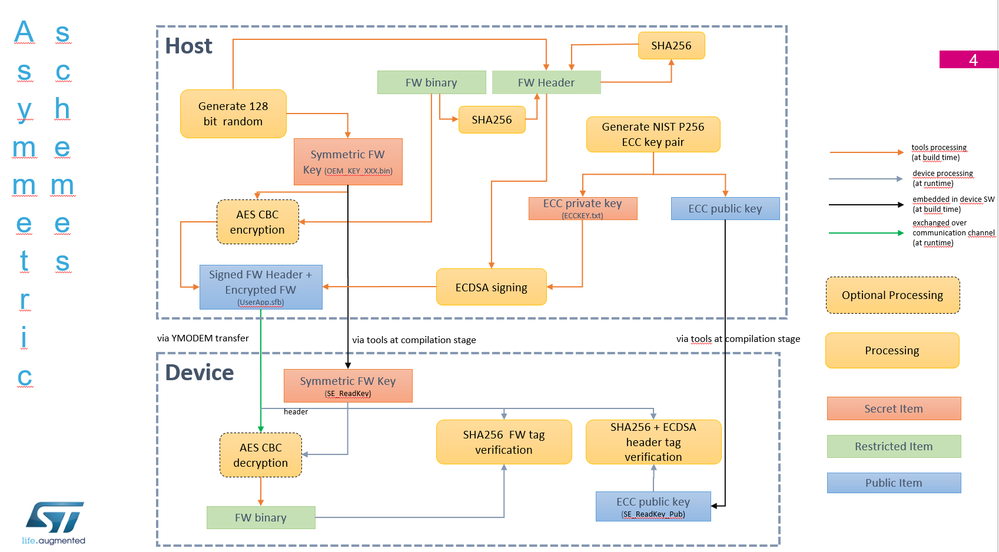

@Fred I cam to know that is the Metadata Header also signed ??
Step 1: Compute HASH of Firmware application and Sign with ECC.
Step 2: Store this Signature in Metadata Header.
Step 3: Then fill remaining Header fill with '0's.
Step 4: Then Sign Metadata Header as well ?? If it is, can we verify with same Public Key ??
Can you please clarify on stages of signing involved in SBSFU, without Firmware encryption ??

The crypto scheme is like this:

@Fred Thank you very much for reply.
By default is this is the signing mechanism we follow or Do we configure to SIGN alone metadata header with SHA256 of Metadata Header.??
Looks to me, we compute SHA256 of Firmware, add this TAG in metadata header and sign Metadata header from example. is this correct ??
2022-09-01 10:05 AM
This is correct. This is the signing mechanism followed by the software.
Both tags are checked during the update:
