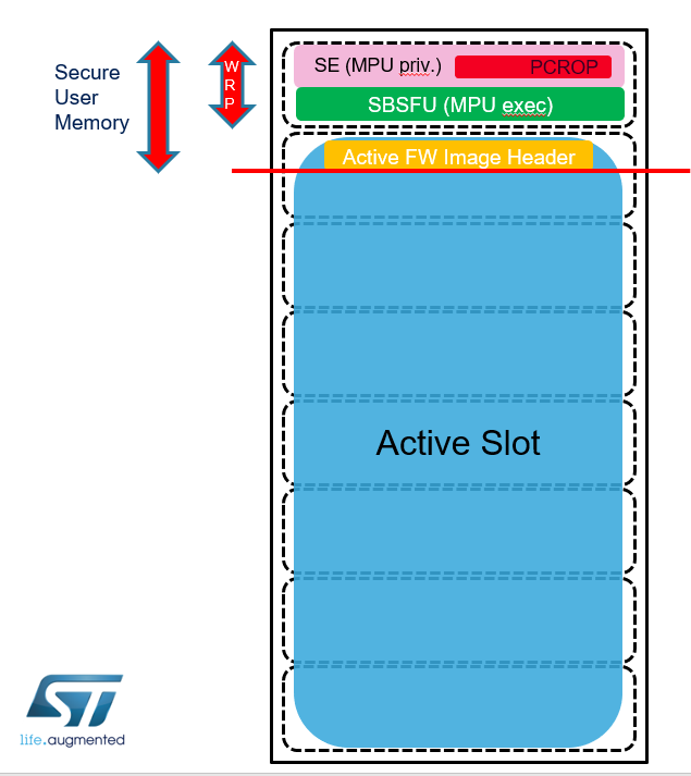

2022-06-27 8:42 AM
It protects also the active slot header:

@Fred To launch the application, we are giving right address by passing SlotStartAdd[SlotNumber] + SFU_IMG_IMAGE_OFFSET. But question is on configuring the secure user memory protection.
From examples, i didn't see that we are applying secure user memory protection to ACT_SLOT Header part.
So, as you mentioned, we should protect ACT SLOT HEADER as well, while configuring through OB, right ??
2022-06-27 11:15 PM
Yes, the active slot header is a sensitive piece of information, it must be protected otherwise we cannot trust the authenticity and integrity checks.
So, from a design perspective, it is clear that it must be protected.
