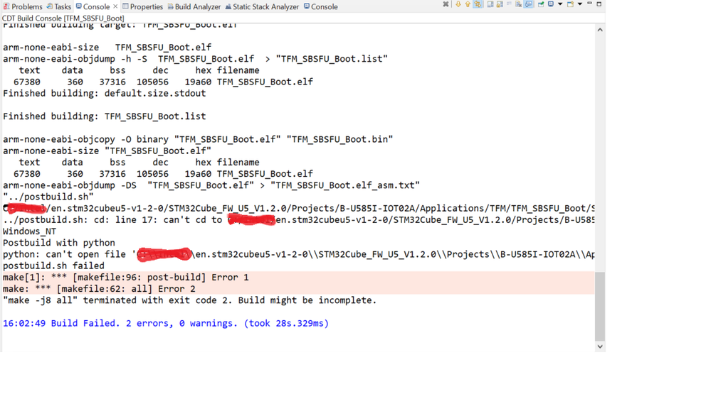

HI All
First of all i would like to thank ST Team for providing an update on the TFM Package. I downloaded the package and am trying to build the TFM SBSFU Package with the following prerequisites
(these are taken from the readme document)
When i build the tfm-sbsfu program from stmcube ide i am getting 2 errors.
I verified the directories mentioned the 2 errors and found the files were present. due to this the postbuild.sh script is failing. (Attaching the error screenshot for reference).
I request help from the channel to know if i have missed anything.
I am refering to the readme files and UM2851- Reference Manual
Kindly assist me
Thanks in advance
2023-03-02 5:35 AM
Hello
is there a space character in the path where STM32Cube_FW_U5_V1.2.0 is installed ?
if yes, try to install it in a path where there is no space, or use DOS subst command to create a new drive letter from STM32Cube_FW_U5_V1.2.0\ and load the project from this drive (in STM32CubeIDE).
