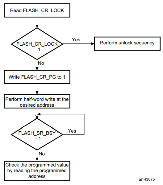

I followed main flash memory programming procedure in PM0075 manual.
the procedure is in below picture.
When only RDP is enabled, I unlocked Flash_CR_LOCK bit and then Write FLASH_CR_PG to 1.

Carefully read pm0075:
Once the protection byte has been programmed:
Pages 0-3 (for low- and medium-density devices), or pages 0-1 (for high-density and
connectivity line devices) are automatically write-protected. The rest of the memory can
be programmed by the code executed from the main Flash memory (for IAP, constant
storage, etc.), but it is protected against write/erase (but not against mass erase) in
debug mode or when booting from the embedded SRAM.
