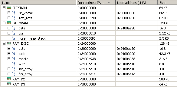

For those interested: here is how I managed to partially solve the problem:
.itcm_text :
. = ALIGN(4);
itcm_text_start = .;
*(.itcm_text) /* Fast-executing code */
*(.itcm_text*) /* Fast-executing code */
cmox_aesfast_decrypt.c.o
cmox_aesfast_encrypt.c.o
cmox_aessmall_decrypt.c.o
cmox_aessmall_encrypt.c.o
cmox_aes_common.c.o
cmox_bn.c.o
. = ALIGN(4);
itcm_text_end = .;
} >ITCMRAM /* AT >FLASH*/
The AT>FLASH will be needed only if the program is designed for flash storage.
This is a brute force method, but the linker will only pick the modules which are called from the user program, and eliminates the unused modules.
Interestingly, the trick moved not only the code, but also the constant tables for the cryptographic functions into ITCM. It might be good to place them in the DTCM for faster access, but I did not yet learn how to do it.

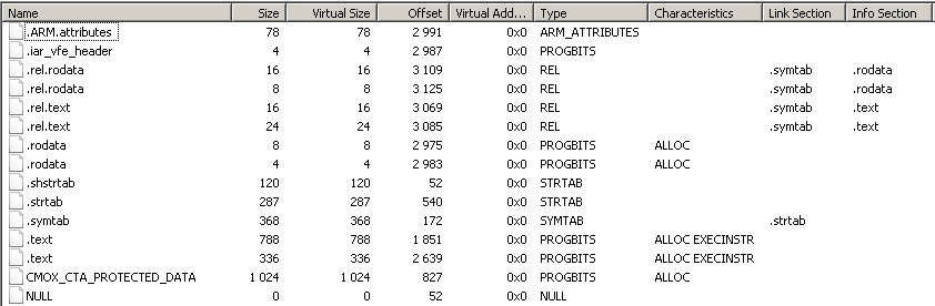

One more hint: the sections are defined as following; that allows to aggregate and remap them:
