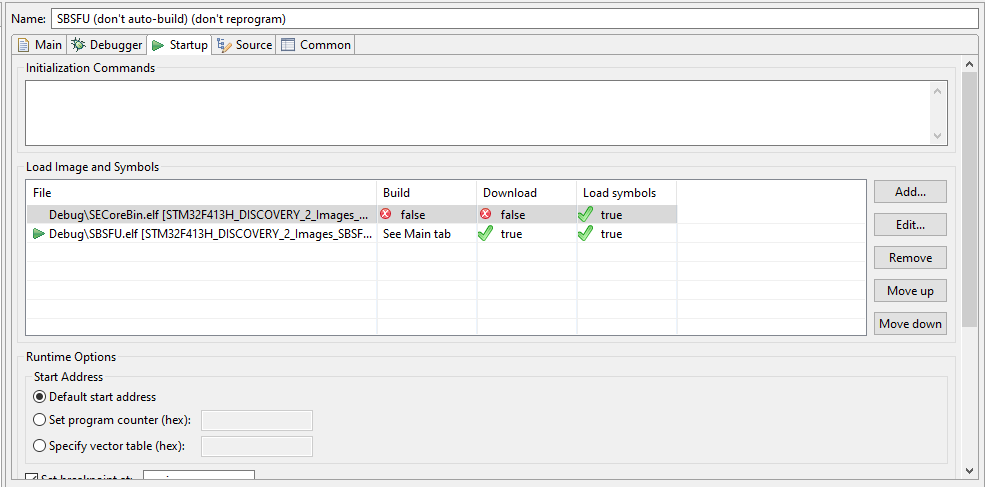

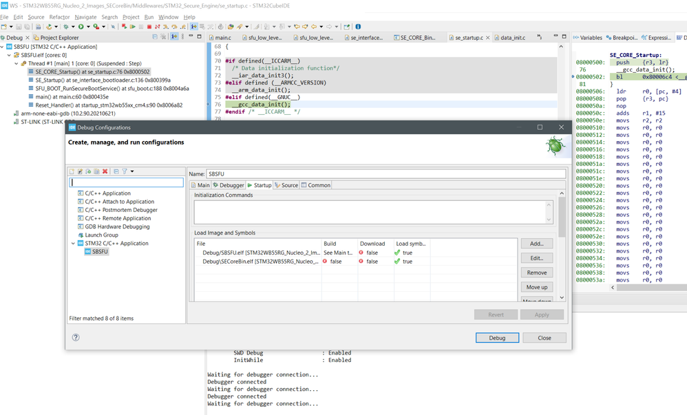

2022-11-14 5:25 AM
Hello Matt,
I made a quick test and with your configuration I confirm it does not work.
To make it work, untick the download of SBSFU and also move the SBSFU line up like this.
I hope this will work better on your side !
Best regards
Jocelyn

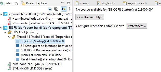

2022-11-14 6:18 AM
Hi Jocelyn,
I have tried unticking the download of both the SBSFU and SE, but still no success. I can debug the code though the SE_SVC_Handler() but once I step into SE_CallGate() I get "no source available". When I try stepping into SE_CORE_Startup() like in your screenshot, I get the same issue. I made sure that the SECoreBin project is also in the source lookup path in the debugging configuration.
2022-11-14 6:38 AM
Hi Matt,
did you move SBSFU line on top in the debug/startup ?
Also, one thing I didn't set "Use symbol address".
Maybe one or other point may help
I'm using version of STM32CubeIDE 1.10.1
Best regards
Jocelyn
2022-11-14 6:47 AM
Hi Jocelyn,
Finally got it! I had moved the SBSFU to the top line, and then had the symbol box checked, but did not set a value. I am now able to debug in the callgate.
