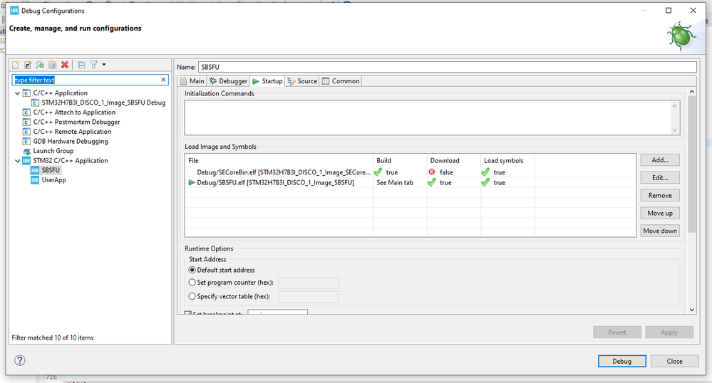

I tried to debug the application as per your suggestions and I am able to debug the application. Here I am attaching the SBSFU and SECoreBin debug configuration in STM32Cube IDE.
Now I want to check my custom application. I have made changes in the se_crypto_bootloader.c to add RSA sign verification. I have also change the length of sign in the se_def_metada.h structure.
When I enable the debug and run the application the SBSFU application work fine and asking for loading sfb using YMODEM. I followed the steps and load the UserApp.sfb file but I am getting an error called Fw header authentication error. I have attached the complete tera term log.

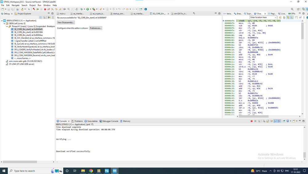

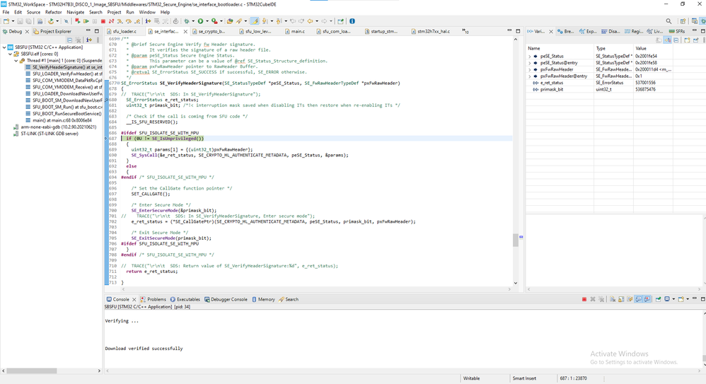

File> Transfer> YMODEM> SendI have tried to debug the error and find that my application is returning SFU_ERROR from SE_ErrorStatus SE_VerifyHeaderSignature(SE_StatusTypeDef *peSE_Status, SE_FwRawHeaderTypeDef *pxFwRawHeader) function of se_interface_bootloader.c file.
After uploading the UserApp.sfb file the debugger stop at the same function and execute the if part and return SFU_ERROR from there. Please correct me if I am doing something incorrect. I am attaching the photo of this section.

On top of Fred's answer, I could add that you can add this elf file directly in the debugger configuration in the startup tab.
Click Add ... buttong, select elf file, deselect Perform build and deselect download.
Leave Load symbols and use address 0.
You should get things working.
Also, as Fred said, you should disable security protections. You can leave MPU enabled: this allows debugging MPU configuration related issues :)

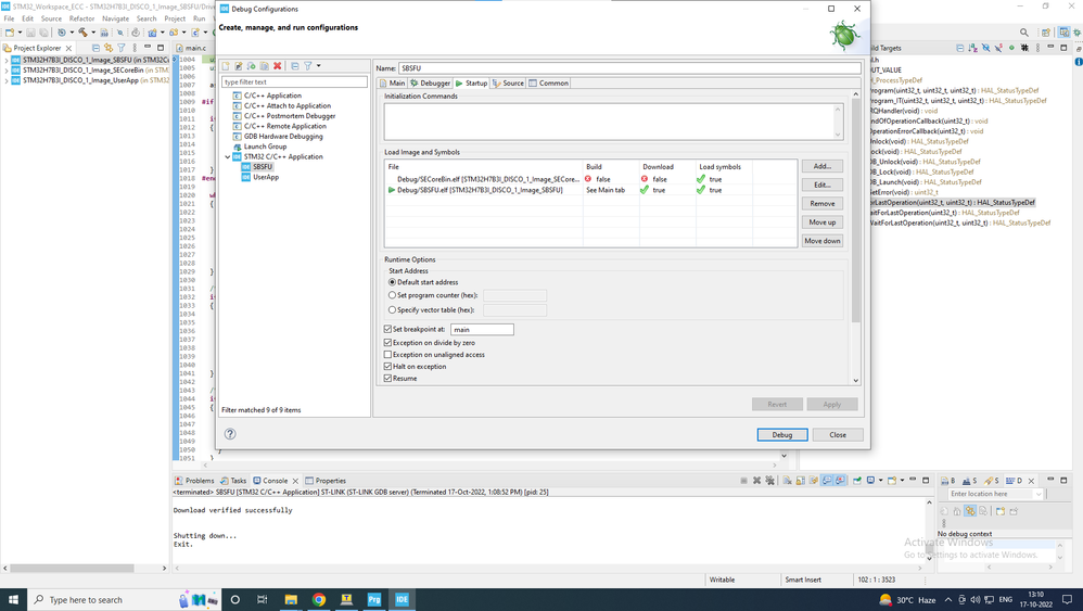

As mentioned in previous posts, I am not able to debug the SECoreBin application in which I have made many changes. I need your support to enable me to debug the SECoreBin application.
The debug configuration is detailed below where I tried to enable debugging of SBSFU and SECoreBin application:
Thereafter, I tried to debug the SECoreBin application by in inserting a breakpoint in SE_ErrorStatus SE_CRYPTO_Authenticate_Metadata(SE_FwRawHeaderTypeDef *pxSE_Metadata) function of se_crypto_bootloader.c. I am getting errors detailed below when I load the UserApp.sfb file and resume the debugging.

2022-10-17 3:59 AM
Hello @Ikbal,
Apparently, you are not able to debug properly.
This needs to be fixed first.
As I said:
you need to configure debugger with
Click Add button, select elf file, deselect Perform build and deselect download.
Then when reaching the last call to SE, you will need to step into in assembly mode.
Debugger is not able to step into in C mode.
All code in SE should be displayed
Best regards
