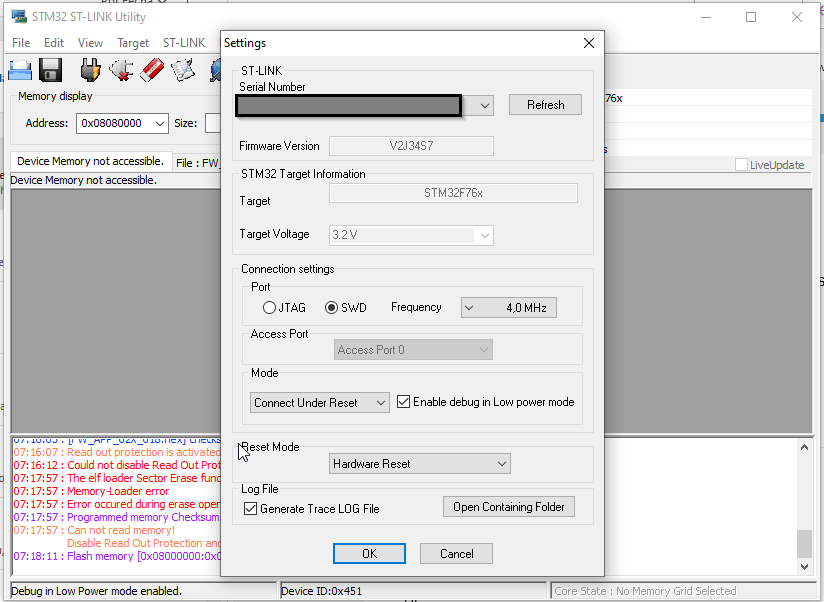

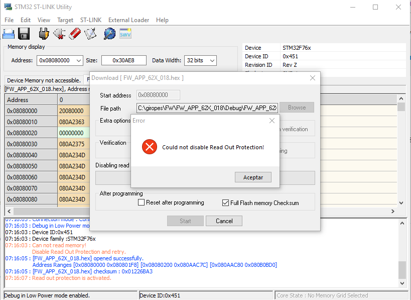

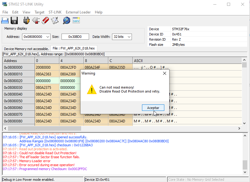

I've tried change it with ST-LINK Utility > Target > Option Bytes, but always appear "Could not set Option bytes! Please reset the target and retry".
I've tried to reset the target, but it don't do any change.
I don't understand why ST software cannot change the ST Microcontrollers if the software seems that has this tool to disable the Level 1 Read Out Protection.

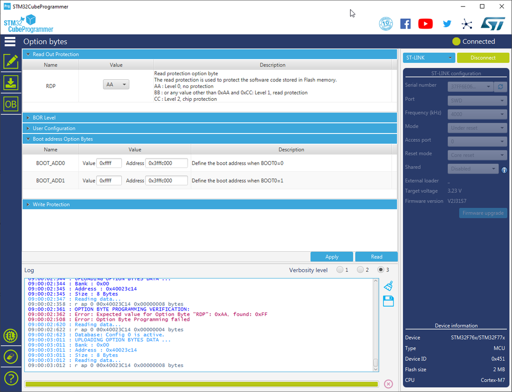

2019-12-05 12:29 AM
I've just installed the STM32CubeProgrammer and try to disable the Read Out Protection, and I cann't do it because the RDP register value is 0xFF instead of 0xAA or 0xBB.
1) How RDP is 0xFF? I consciently don't change it...
2) How I can change this value?
Thanks

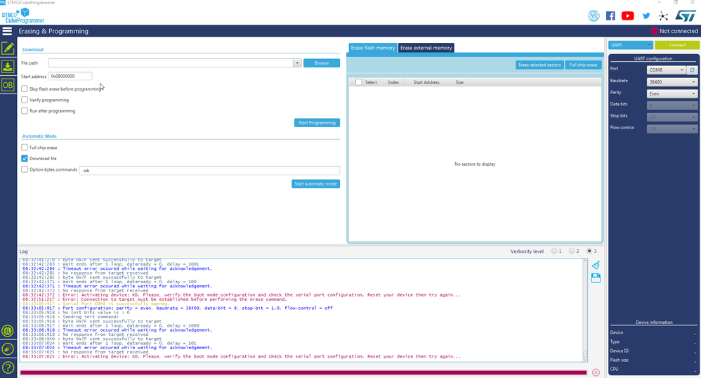

2019-12-09 12:48 AM
I've connected the boot to 3V3, and the USART1 TTL to my PC with an FTDI TTL cable, and the result it is the same: "Activating device: KO. Please, verify the boot mode configuration and check the serial port configuration. Reset your device then try again..."

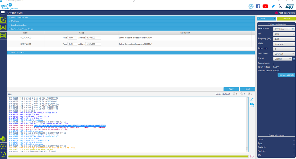

2019-12-09 12:50 AM
Also we have the BOOT_ADD0 and BOOT_ADD1 corrupted, because it is 0xFFFF and we cannot change to 0x40 or others. Why it is corrupted?
I don't understand anything...
