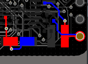

2022-04-15 7:37 AM
I have checked the ground connections but finished all of them. On the design, I recognized that the ground connections were connected to each other through the GND plane, not connected directly with traces. Does it cause this issue? I attached what I mean by sharing a small of the PCB layout.
I flashed the codes, and the BOOT0 is grounded every time. So, this is the ideal case, isn't it? In addition, the NRST is connected to the debugger connector. Does it cause this issue? @Community member
