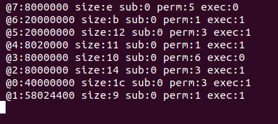

I changed the size of the header MPU region to 256K to cover both sectors of the header, but when the board is flashed, the SBSFU fails to run. Turning on the verbose debug mode produces this output:
Seeing this, I changed the mapping and tried to see if I could group the headers into one sector and apply MPU on that. So, I changed the MPU region size to 128K and changed the second FW header address to 0x0803000.

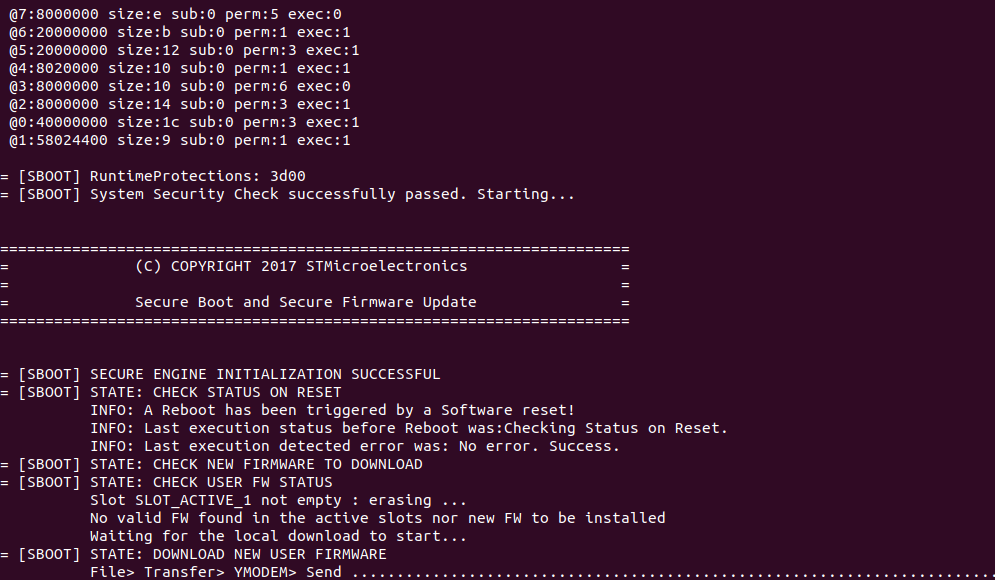

This seems to satisfy the MPU check, but when run the SB produces the following:
It seems to no longer be able to verify firmware images and deletes any images sent over immediately.
