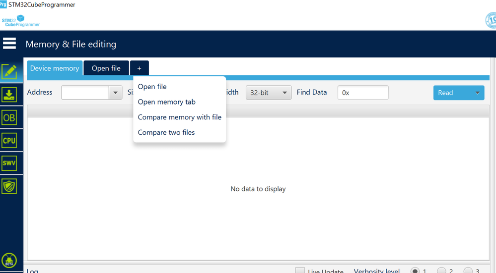

If you want to verify that your code has been written correctly on your MCU, I would recommend to use STM32CubeProgrammer.
In the "Memory & File editing" tab click on "+" and "Compare memory with file" , then select your .hex or .bin file to compare with the internal memory .

Also please see the above picture, how memory comparison works, after memory is protected?

@VTver.1 , once protected your firmware won't be accessible even by STMCubeProgrammer. The picture above works only if the device is not protected
