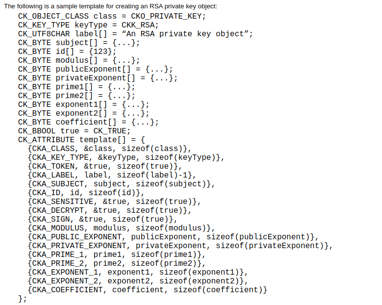

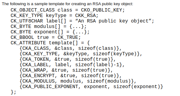

@Fred Thank you for the precision. So If i am not able to use it, I think I will go for another algorithm (RSA) as I can see from the provided example project that it is possible to sign and verify using RSA.
If I use openssl to generate a RSA key pair, do you know how I can translate the .pem files to these objects :
(public)
(private)
Thanks,
Benjamin
2022-05-23 4:18 AM
There is an example of encoding in "kms_blob_example_keys.c".
But I can check with the colleague who developed it how he created the data.
2022-05-23 4:33 AM
Yes I saw the example but I was wondering how the data was generated. I think the required information can be found using
openssl rsa -in <my_key.key> -noout -textbut if you can check with your colleague that would be very much appreciated.
