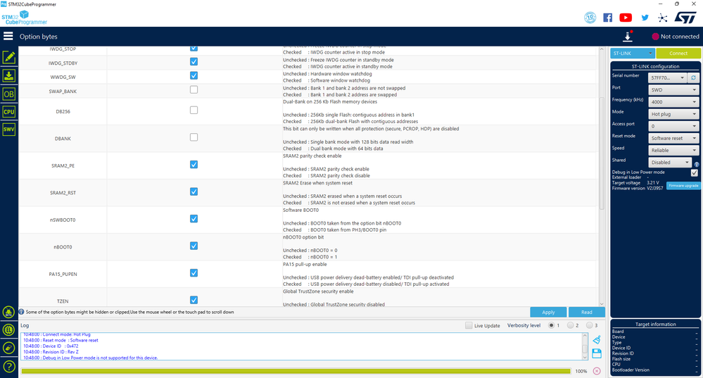

i am enable trust zone and I make one part as secure world and another part as a non secure world using (SECWM1, SECWM2) but forget to enable Dbank as (Dbank = 1) now I couldn't make any changes in option bytes
my question is
1.how can I enable dual bank mode (Dbank = 1)?
2.if I will launch my both binary what will happen?
3.what are the steps to recover my device?
