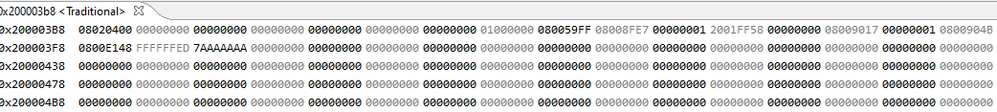

.endValue of LR,SP
Memory of stack pointer :
2) LR : 0xFFFF.FFF9 return from Handler mode so NVIC does unstacks PC, R0-R3, R12, LR, xPSR

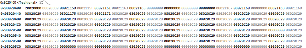

3) Application memory at 0x8020400
Which also looks about right.
