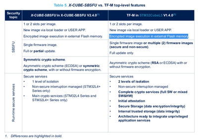

One confusion I do have is that AN5447 lists "Encrypted image execution in external Flash memory" as a top-level feature for the TF-M based SBSFU solution:
I'm not seeing evidence of this, at least not in the STM32U5 example. Am I missing something, or is this table just saying this is possible (but the actual implementation is an exercise for the reader)?

I'm surprised the UM2851 is not covering the use of external flash for application image, because the older UM2671 that exists for the older STM32L5 is describing this topic. Maybe you can find some helpful information in the STM32L5 examples and documentation. It's similar product, most should be applicable on stm32u5 as well. BTW the table from AN5447 you asked about is also referring to the STM32L5.
