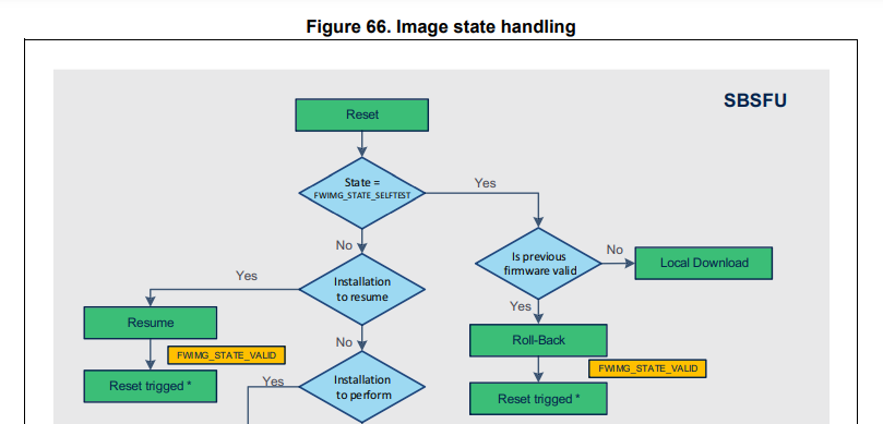

Nevertheless, the code doing the swap is still present and for some specific needs we have implemented an "image state" management logic:
#if defined(ENABLE_IMAGE_STATE_HANDLING) && !defined(SFU_NO_SWAP)
/* Move the state to SELFTEST for the new images */
if (SFU_IMG_UpdateImageState(SLOT_ACTIVE_1 + i) != SFU_SUCCESS)
/* Image state cannot be changed : What to do ?
==> decision to continue execution */
TRACE("\r\n= [FWIMG] WARNING: IMAGE STATE CANNOT BE CHANGED!");
#endif /* ENABLE_IMAGE_STATE_HANDLING && !(SFU_NO_SWAP) */
You can get more information about it in UM2262, Appendix J.
But, please keep in mind that this can be seen as an attack opportunity, so you need to analyze if you want to use it or not.

2022-06-06 7:16 AM
Yes, you can check Appendix J figure 66 in UM2262:
If the previous firmware image is not tagged valid then we end up in local loader mode.
Nevertheless, if the firmware got corrupted without the valid state being updated then maybe you can revert to an invalid firmware. You must check this kind of cases.
Using UART increases the attack surface, so yes you open the door to new risks.
You must assess carefully the code dealing with the UART communication and decide if you trust it or not.
As soon as you transfer data, you deal with buffers so you can have bugs in this area leading to security breaches.
